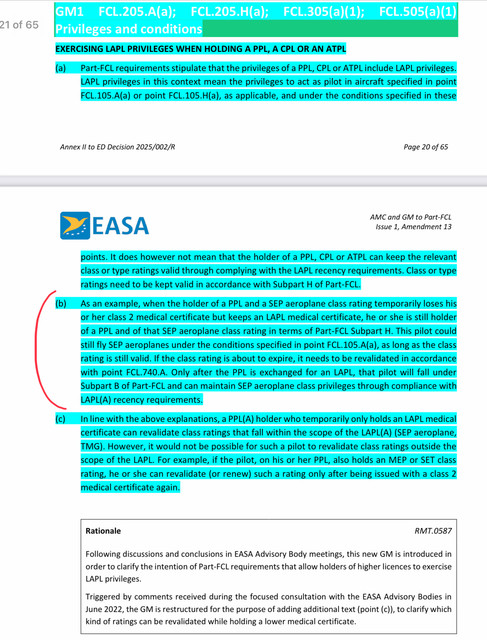

Maintenant on a un GM dans FCL (depuis 25) qui dit qu’il faut que SEP soit valide pour exercer en LAPL
https://www.easa.europa.eu/sites/defaul ... ent_13.pdf
C’est un GM, “guidance” de “bonne pratique”, ce n’est pas une “implémentation rule IR” ou “AMC” qui sont des ”vraies lois”…on peut ignorer les GM des fois: avec PPL DGAC et avion Foxtrot en vol en France, tu peux ignorer ce genre de GM…

La réponse est là mais la question initiale n'est pas claire : pascalout qu'as tu comme qualif sur ta licence?
GM1 FCL.205.A(a); FCL.205.H(a); FCL.305(a)(1); FCL.505(a)(1)
EXERCISING LAPL PRIVILEGES WHEN HOLDING A PPL, A CPL OR AN ATPL
(a) Part-FCL requirements stipulate that the privileges of a PPL, CPL or ATPL include LAPL privileges.
LAPL privileges in this context mean the privileges to act as pilot in aircraft specified in point
FCL.105.A(a) or point FCL.105.H(a), as applicable, and under the conditions specified in these
points. It does however not mean that the holder of a PPL, CPL or ATPL can keep the relevant
class or type ratings valid through complying with the LAPL recency requirements. Class or type
ratings need to be kept valid in accordance with Subpart H (SUBPART H – CLASS AND TYPE RATINGS) of Part-FCL.
(b) As an example, when the holder of a PPL and a SEP aeroplane class rating temporarily loses his
or her class 2 medical certificate but keeps an LAPL medical certificate, he or she is still holder
of a PPL and of that SEP aeroplane class rating in terms of Part-FCL Subpart H. This pilot could
still fly SEP aeroplanes under the conditions specified in point FCL.105.A(a), as long as the class
rating is still valid. If the class rating is about to expire, it needs to be revalidated in accordance
with point FCL.740.A. Only after the PPL is exchanged for an LAPL, that pilot will fall under
Subpart B of Part-FCL and can maintain SEP aeroplane class privileges through compliance with
LAPL(A) recency requirements.

Je pensais que c'était une invention de la DGAC mais c'est dans le manuel de l'instucteur de l'EASA. Je ne sais pas pourquoi. Je me rappelle avoir fait une prorogation de QT en UK avec licence UK sans médical ça n'avait pas posé de problème, mais c'était post EASA.
Extrait du manuel EASA
Before proceeding with the test or check, the Examiner shall verify that the prerequisites are met; if applicable, the ATO/DTO shall make available the training records for verification if requested. Accordingly, the following documents and conditions shall be verified:
• Passport or ID
• PPL(A) or higher
Medical EASA Class 1 or 2, with IR checked if IR revalidation/renewal is included
• Radiotelephony privileges and language proficiency requirements
• EASA logbook, showing the relevant minimum experience and flight instruction
• Relevant CR/TR(A) skill test form filled, endorsed by the ATO if applicable
• Aircraft documents
• Current navigation charts, and database if applicable
• Insurance of aircraft covering check flights
• Specific equipment for the flight part (e.g. sight-limiting device)

dans l'échange on a :
Pour la prorogation par expérience c'est facile, tu fais ton vol double commande avec un FI ou CRI, et tu fais la demandes sur SIGIBEL toi-même et c'est bon, pas besoin d'une class 2 valide.
Le nouveau GM du FCL (2025) nous impose d'utiliser la validité PPL/SEP pas l'expérience glissante LAPL/SEP, c'est une différence administrative,
j'espère que l'instructeur FI saura qu'avec une SEP encore valide, il peut valider ma prorogation SEP à la suite du vol de "controle" satisfaisant en ayant l'expérience requise pour proroger PPL et un certificat LAPL valide pas de medical classe 2 car la phrase suivante dans le forum m'interpelle:
Malheurseument, les examinateurs en France refusent de faire tests SEP: contrôle de compétence, prorog par experience ou renouvellement...sans medicale C2 valide ( même quand le médical LAPL est encore valide), pareil pour les tests IRSE sans Audiogramme valide (même avec médical C2 valide) Est ce à dire que les instructeurs FI acceptent de proroger une SEP de PPL avec un certificat valide de LAPL ?
Est ce à dire qu'en 2026, on ne doit pas rester avec un médical LAPL sur une licence PPL encore valide selon Ibrabell et demander à convertir la licence PPL en licence LAPL avant la date d'expiration de la SEP du PPL ? faudrait donc considérer que la note de la DGAC de 2023 est déjà devenue caduque en 2025-2026 et que personne ne le sait encore ? C'est compliqué le sujet... que vont devenir les pilotes qui ont PPL avec une SEP non valide et un médical LAPL et qui vole encore selon la note de la DGAC qui n'echangeait plus les licence PPL contre des LAPL ?
dois je donc faire les heures du PPL pour avoir l'expérience pour la SEP et demander à défaut de ne pas pouvoir renouveler la SEP demander l'échange rapidement en LAPL à la DGAC tant que la SEP est valide ?

Oui la lettre de 2023 est devenue caduque
Pour la prorogation par expérience, tu n’as pas besoin de médicale (ni PPL, ni LAPL), tu fais 1h double en PUT, l'instructeur est CdB, et puis tu fais la procédure par SIGIBEL.
Pour la prorogation par test (ou renouvellement par test) d’un SEP, tu as besoin d’une C2, l’examinateur ou le bureau des licences va te le dire...

pascalout a écrit : 27 avr. 2026, 21:10 je pense que la question mériterait une réponse de la DGAC de d'interprétation du texte de l'EASA devant cette complexité

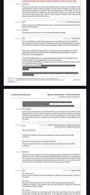

L'AESA, DGAC et FOCA étaient hyper pragmatiques sur la dégradations PPL -> LAPL, une fois ton SEP est expiré, il suffit de faire en validité glissante avec une médicale LAPL
Par contre des pays comme Royaume-Uni, Norvège ont fait une grosse objection à cette interprétation. Un truc commun à ces deux pays c'est qu'ils autorisent les tests sans médicale.
Le résultat de cette NPA (2014) et GM (2025) c'est qu'en France, on a fini avec une "guidance" de m*** sans avoir la possibilité de faire les tests sans medicale...
Voici les opinions des autorités et AESA sur le sujet du PPL -> LAPL, c'est loin d'être "risk-based" mais plutôt "paparsse-based" !
https://www.easa.europa.eu/en/downloads/23368/en
C'est un désavantage de copier les pratiques d'un pays dans un autre pays sans voir the "big picture" !
Une solution simple c'est de permettre les tests (prorogation & renouvellement) sans médicale au niveau de l'AESA (il faut changer FCL.1030 pour permettre ça)
Voici la mise en œuvre par DGAC Francaise et FOCA Suisse: tu peux voler en "mode LAPL" avec un SEP expiré
Voici l'interprétation de la Norvège: objection !
Voici celle du UK: objection !
Voici la Finland,
L'IAOPA veut aussi que tu gardes ta qualification de classe SEP à jour !
Cette histoire de QC valide pour exercer en LAPL marche bien en prorogation par expérience mais si ton SEP expire avec médicale LAPL, tu es dans la m***e !
